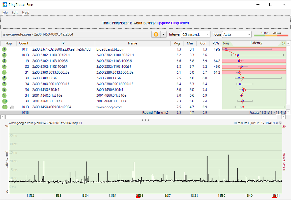

Attached is a ping plotter snapshot for the last 45 minutes.  You'll see the spikes at frequent intervals.

Looks like a major issue with your local area network, 52% packet loss from your PC to the router suggest some sort of interference.

Thanks h3x1e
I didn't even look at it properly so thanks for pointing out the obvious. I'm running a USB wireless dongle. Ping and speed is generally fine but I'll try hard wiring tomorrow and see how that goes.

The ping spikes amazingly stopped after about 5pm yesterday having been constant since last week.  Seems relatively stable this morning too but I'm still getting 50% packet loss my side?
I've connected directly to the BT hub this morning by ethernet.  The hub is connected direct the BT MK2 socket (assuming this is the master socket).

Do you have an old ADSL Filter? The test socket is the bigger one on the bottom right of the socket.
Could you also try running a ping at 1 second intervals and not 0.5 second as it's been known to cause some weird results.
Can you also try an IPv4 ping using ipv4:www.google.co.uk
It is looking much better though, if packet loss isnt visible at the destination on the ping then there ususaly is no reason to be worried unless you're still getting issues.
