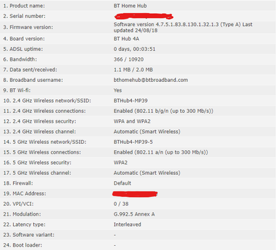

can you post hub stats
check for line noise as something is dropping your connection. Dial 17070 option 2 should be silent and best with corded phone preferably from test socket

Hello,
Thank you for the reply.
I do not have a phone to use the phone line.
Here are the stats:

The most basic check when you have problems with your broadband is ensure your landline is working with a dial tone and then do quiet line test as noise is the normal reason for a poor/dropping connection. If you don't have a phone you try borrowing one although cheap corded phone is less than £10
hopefully problem not on your side of test socket and you end up getting charged for engineer visit
