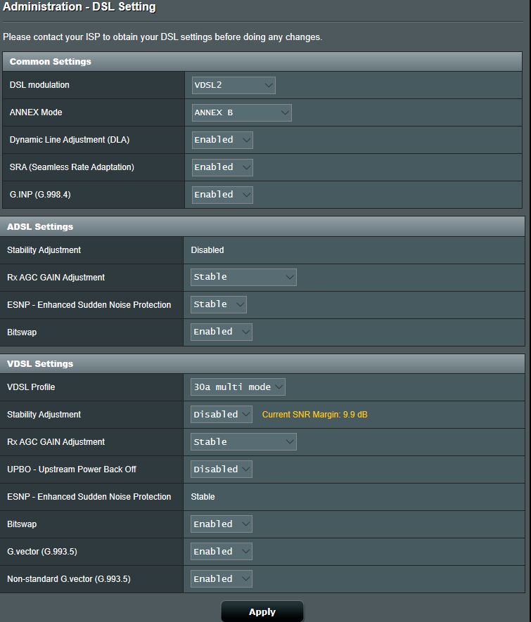

Message 8 of 36
Re: Help with Asus DSL-AC68U
Go to solution
I was having an issue uploading from my phone, ive had to tether my 4g to the laptop to try and upload.. here are my settings. Thanks again in advance.Capture.PNGCapture2.PNGCapture3.PNGCapture4.PNGCapture5.PNG
6,010 Views
Message 9 of 36
Go to solution
is the time and date correct on the Router? If there is such an option
Since it seems kinda 4 years wrong 😛 see if you can change it.
Also you could try setting the Greenwich Mean time to British Summer Time or GMT +1 if there's an option
6,002 Views
Message 10 of 36
Go to solution
should web access from wan not be yes
