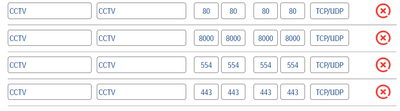

I've set a static IP on the device itself, and this is seen and recognised by the Smart Hub. I've also set-up port forwarding (or at least tried to) for the ports 80; 8000; 554 & 443 - this is the same as I'd done previously on the Sky router and is consistent with port settings listed on the Hikvision device itself.
I use a DDNS service via No-IP, and I've checked that everything is consistent across the devices.
If I check the ports via a service like yougetsignal.com, 8000 and 554 still appear to be closed - even though I've set them the same as ports 80 and 443 which return a positive open result.
I've turned off Smart Set-up on the BT Hub and have tried a couple of different static IP's, but still getting the same issue.
