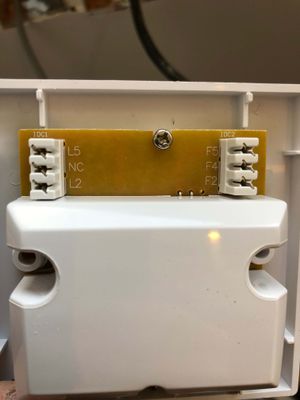

Thanks, I have a Cat 6 connection block, and I also have gel blocks.
but was i was planning on connecting the telephone cable into the back of the filtered socket and then coming out the same socket with the CAT6 cable?

Re: How to connect main by cable to Cat6 colours
 where would the orange and white cable  from the main phone line go and then where would I put the CAT 6 cables ?
That’s not a Socket I’ve ever seen before but would say the Orange goes into L2 and the White into L5.
I’d then hazard a guess Pair 1 of your Cat6 Cable, that’s Blue White/Blue would would go Blue F2 and White/Blue F5.
What socket would you recommend, I did have a openreach filtered socket before it got damaged so this time I just brought a filtered flat plat socket as the openreach sockets are very bulky.
