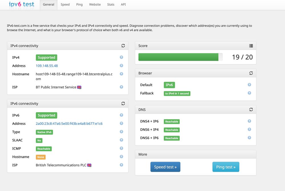

Don't have the router plugged in any more. I recall when testing with https://ipv6-test.com/ I had either:
- IPv4 Connectivity all unsupported (with IPv6 connectivity), DNS4 + IP6 working, DNS6 + IP6 working
- IPv6 Connectivity all unsupported (with IPv4 connectivity), DNS6 + IP4 working
I tried with using BTs DNS servers, Google, NextDNS and all had the same results from what I can remember.
In comparison with an ASUS router I have switched to (AX86U), I have the following (after testing now):Screenshot 2023-02-05 at 13.57.39.jpg
