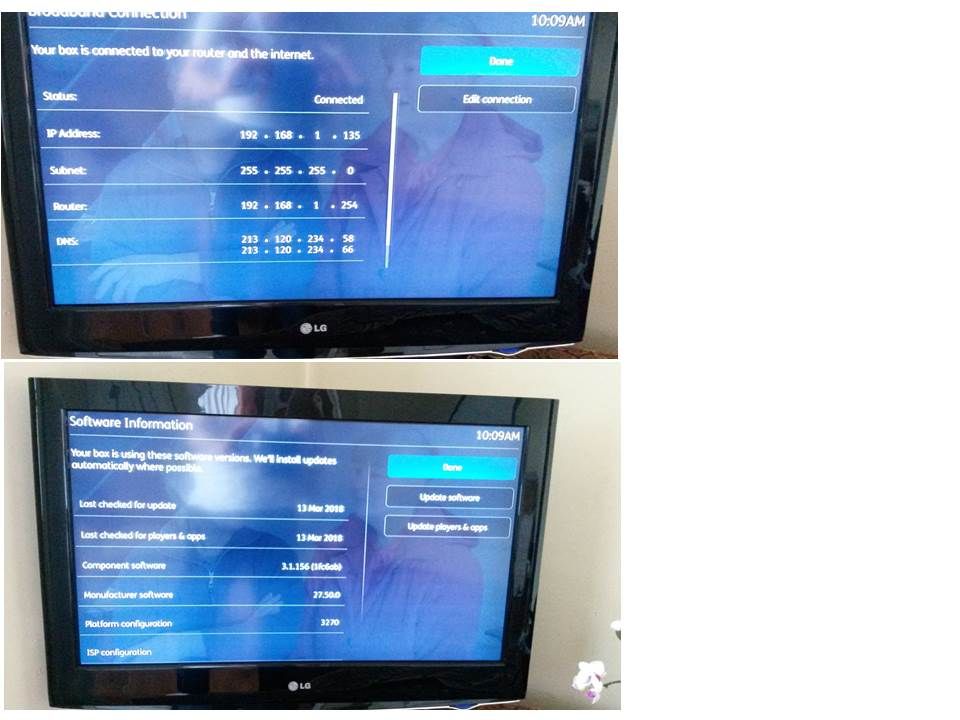

Hi I have an old BT Humax YouView box a DTR-T1000. I recently did a full factory reset on the box deleting everything and downloaded the new software.
It has update the On Demand Players (Iplayer etc) but none of them will work (I get YVM104)
I have a HH5 which I have factory reset and am using powerline adapters. My On Demand players work fine thorugh the same network setup on my BluRay and Now TV Box.
But they will not load on my Humax Box - any ideas I suspect its a DNS issue.  It IS connected to the internet.
Piccies attached.Connected to internet bu No ISP ConfigurationConnected to internet bu No ISP Configuration

Have had the YVM104 error code 3 times in 2 weeks, checked for App and Software updates, all were up to date. Then went into Internet Connection settings, selected Edit Connection Settings, selected Automatic and the device went into a mode of trying to connect to the router and the internet (although already confirmed connected on previous page) and once confirmed connected all Apps and Subscription services were available as normal.
