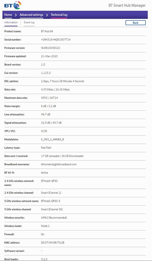

in order for the forum members to help please can you post the stats from your router (if hub enter 192.168.1.254 in your browser) and if  HH5 then go to troubleshooting then helpdesk and if HH6/SH2 then advanced settings then technical log information .

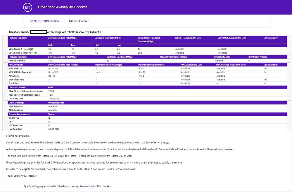

did you check using 'HELP' at top of page and then check service in your area just in case it is not just you
enter your phone number and post results  remember to delete number   https://www.broadbandchecker.btwholesale.com/#/ADSL

Already checked the service status in the area - no issues.
Line test is completely silent. The stats page & checker return data are below.
Thanks
