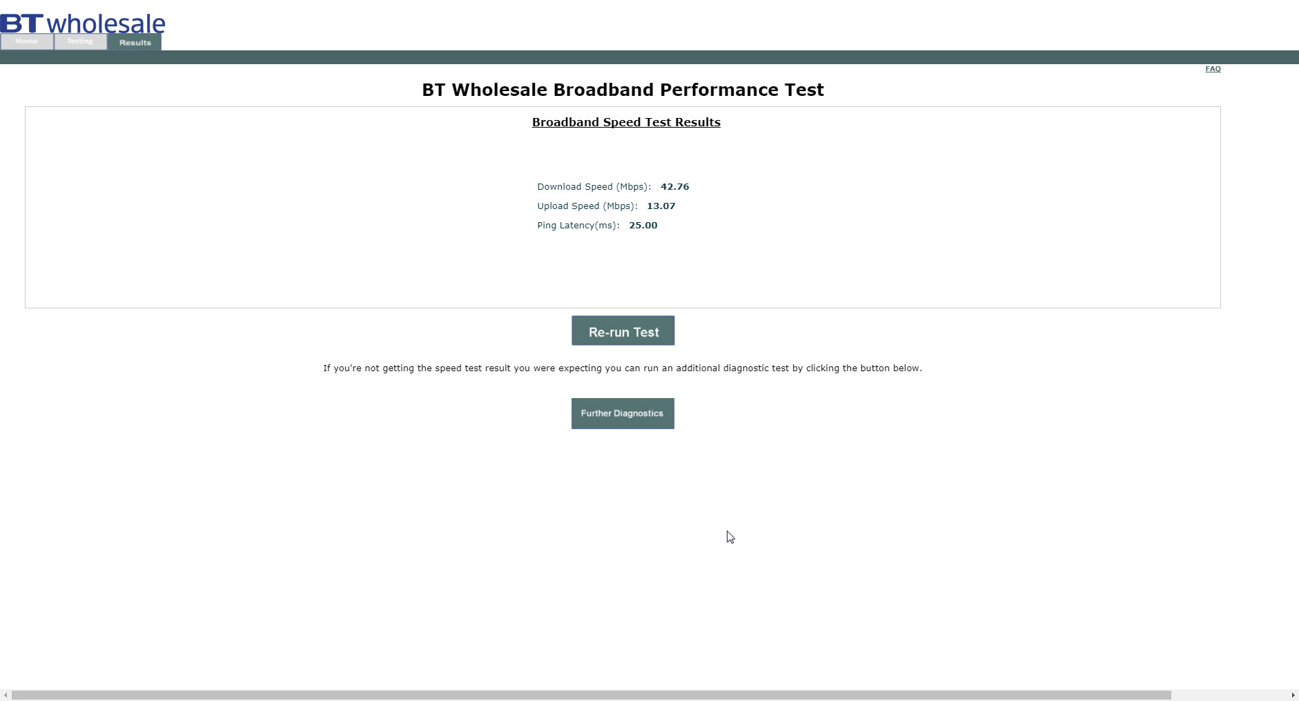

This speed is confirmed on the BT Wholesale speed test:
Nothing has changed with my internal network setup to cause this drop. However, in the past I've had issues with the DSLAM, though I'm struggling to recall how this was resolved? I've logged the 'fault' with BT, however the helpdesk guys that I've spoken with so far suggest there is little that I\they can do...

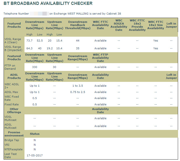

Here's the ADSLChecker results as requested:
Thanks in adv.
