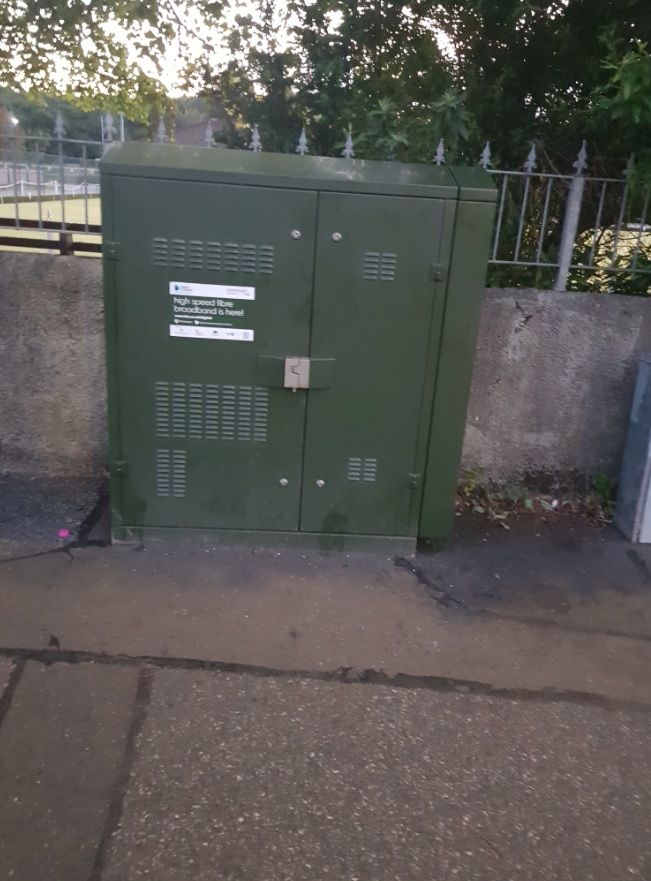

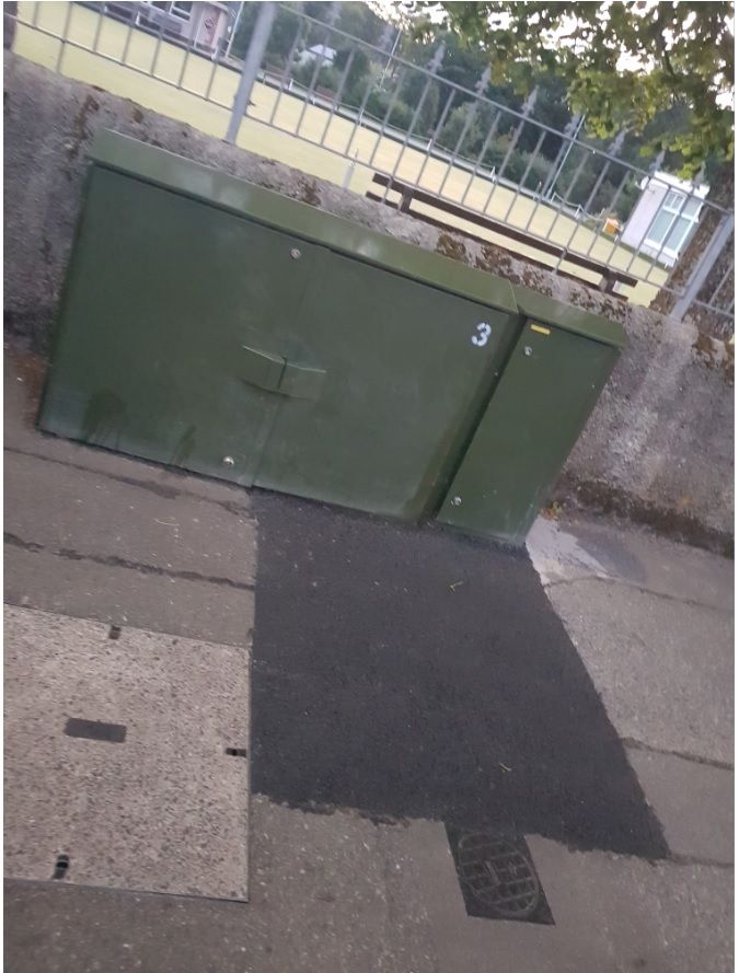

I have noticed what look like new g.fast pods appear next to some of the cabinets in  town and I was quite excited at the idea of faster internet since my house is quite heave on usage ( luckily we get 80/20 ). Recently the cabinet that servers me got two addictions a pod on the copper cabinet but it doesn't look like any of the other g.fast ones and a small attachment was made to the right side of the fibre cabinet. Shortly after that I had a line disconnect over night which lasted half an hour and when it came back my line speed was the same but my line stats had changed quite a bit. So I'm curious if all this has some thing to do with g.fast? hopefully 🙂

Both are just for increasing capacity. The pod on the main cabinet to increase the copper capacity and the extension on the FTTC cabinet to add more ports.
Also Openreach have suspended the deployment of G.fast for the foreseeable future with preference for FTTP instead.

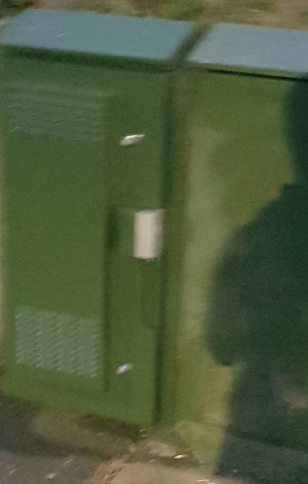

Ah I  thought it was too good to be true. Is this a g.fast pod? I went to the other side of town and noticed more additions to the other cabinets through town and it looks a lot more like a g.fast pod from pictures I've seen of them. Is this a g.fast pod? 20200901_210115.jpg
Apologies for the AWFUL photo I had to cut and zoom the picture in so much to be able to upload it to the forum.

Yep, that’s a G.Fast pod.

Not necessarily, Openreach have been using them to increase Capacity for VDSL as it’s quicker and cheaper than installing new Standalone RDSLAMS.
Theres loads round my way that are for VDSL and not G.Fast.
As someone mentioned Openreach have suspended the G.Fast Roll Out in favour of FTTP until April 2021 and to be honest I can’t even see them continuing with G.Fast after that, or at least not on the scale of 10 Million they’d originally set out to so.

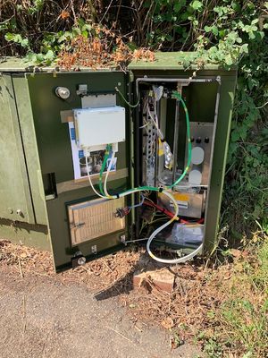

Any of the vented pods like in your blurry image are likely to be VDSL Sidepods.
The codelook website can tell you if it's a VDSL Sidepod but it isn't always up to date.
OpenReach have also started deploying Subtended Head-Ends (mini_OLTs) in identical pods.
I've attached an image of a Nokia S.H.E
So that's now G.Fast, VDSL and FTTP equipment all in identical pods.
The vast majority being deployed at the moment are VDSL Sidepods.
