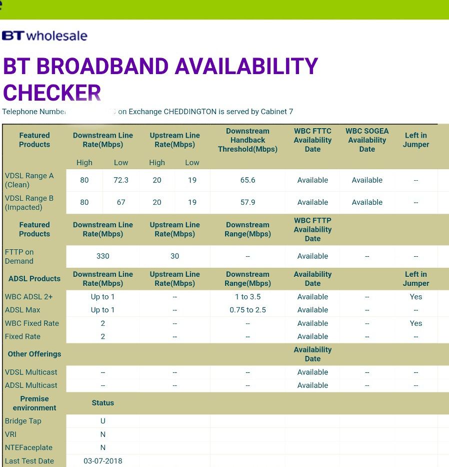

Hello, thank you for responding. I am using a double master socket. I have run the BTW speed test and got the following results:
Download speed: 0.61
Upload Speed: 0.02
Ping Latency : 0.00
Please see images of technical data:

There is something seriously amiss here and it is not going to improve with the mythical 10 day stabilisation period. You need to go back to CS and get them to fix it.
Hmm, cab 7 was enabled for fibre back in 2014,  I wonder if you are actually connected to another cabinet.
Which village are you in?

I can't find cab 7 on Google Street view, its supposedly in Mentmore. If that is the case, the checker figures don't stack up.  You would need to be within about 200/300 metres of the cabinet to get the projected speeds. Do you know where the green cabinet is located?

Even though exchange a long wat away your street cab must be reasonably close with the dslchecker speed estimate
from the stats you certainly need a broadband engineer visit to sort out your connection so phone customer services and get appointment
