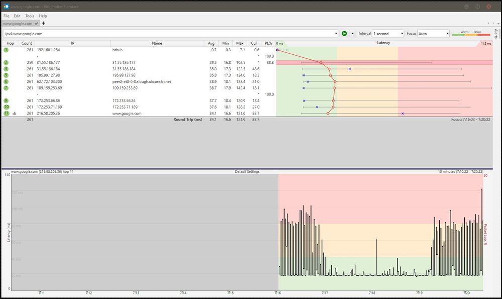

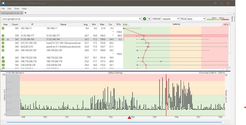

Since the net issues have now settled down, no drop outs, stable sync speed at 35Mbps with a throughput of around 4MB/s I thought i'd post some pings again.

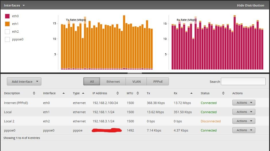

Below shows maximum network usage of ~15Mbps (thats with 2 twitch streams running) accompanied by a ping to google. Ping issues still persists as you can see with zero change to route.

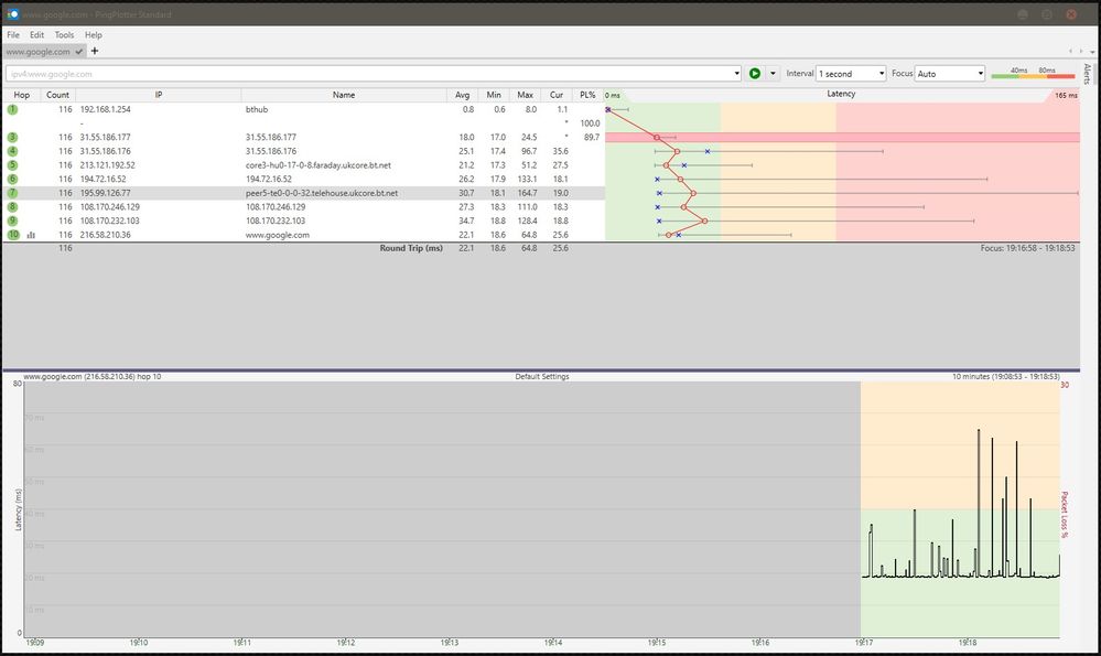

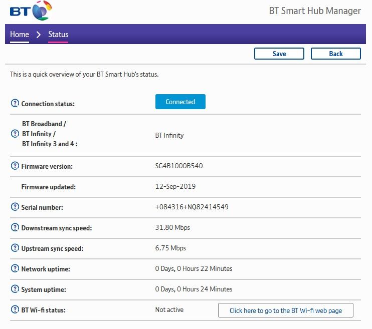

Just had a call from the MOD working with me on this, asking if I could change back to the BT Hub as the OR Engineer did put in his report that I wasnt using the standard BT kit, so that I have done.
Now running on standard BT Smart Hub, Ping issues are still present, will be posting ping potters and other results over the weekend to show this.
Below shows nothing has changed except Sync Speed.3
Don't look at the bottom graph it really doesnt show an amazing amount (only ther destination ping) Check the first 7 hops which is BT's network and take note of the max ping.
Previous Setup:
Street Cabinet > DreyTek > EdgeRouterLite > Unmanaged Switch > WiFi Solution + Wired Devices.
BT Setup:
Street Cabinet > BT HUB > Wired Devices + WiFi Solution
(Note: WiFi is OFF on BT HUB)

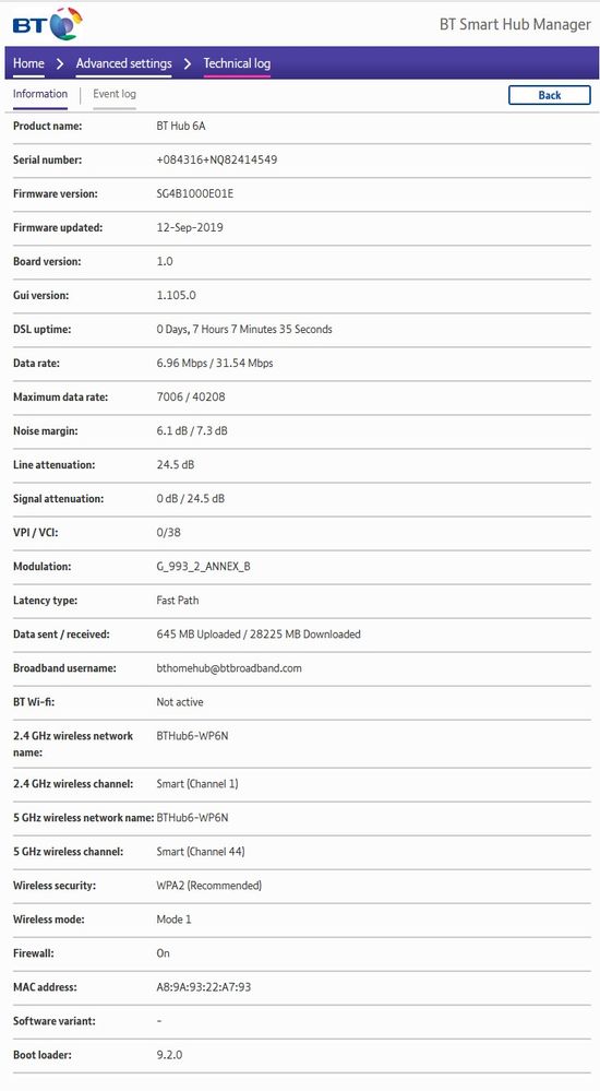

Sync Speed:
867 Views

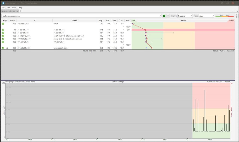

Net dropped around Midnight Last night, nothing much changed, other than Downstream SNR changing to 7.3dB etails below.
Ping issues unchanged, still spiking during streaming.
As with before, showing destination IP ping in the graph and there's nothing much BT can do about ping after their netowkr, but note the "Max" ping on hops 3-7 which is BT's network, it would spike to close this level every 10 seconds or so.

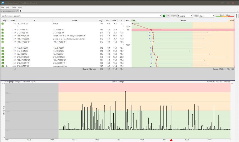

Evening ping test while watching a stream, also while not watching a stream.
Thing to note here is average ping while streaming from Twitch (red line with red circle) compared to current ping (blue x) Then compare that to the below ping when not watching a stream via twitch.
Ping does spike a bit in the "idle" state but im not the only one using the network, someone else is web browsing so I put the small spikes down to that. ON the whole though average ping is in line with current ping.
