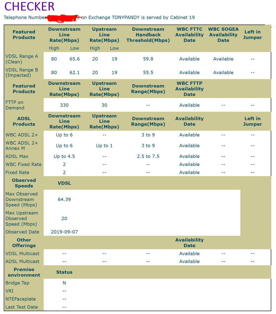

which exchange and cab are you on?  find it here by entering phone number  https://www.dslchecker.bt.com/adsl/adslchecker.welcome
from other forum posts it appears that once your latency is changed by DLM to interleaved then it does not move back to fast unless you get a DLM reset  if your line has stability problems of errors or both then DLM will take action again

just checking to see which type of cabinet but it is ECI so at present no boost in connection from G.INP
