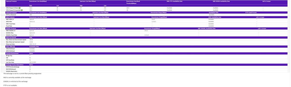

Openreach dug the wires up but could not find any damage but while they where pulling on them my connection kept dropping so they replaced a 2mtr section with new and 2 joint boxes. The speed has certainly increased to an acceptable level of fibre essential. I have been testing and get around 36mbps down and 9.5mbps up now. But I am still concerned that a checker says my line still has a bridge tap and that eventually the speed will slowly decrease like it has done other times after the dlm has been reset. Do these figures look ok? the engineer  told me there was an internal fault in the 2mtr section and I have no bridge tap this was on 23/11 but the bridge tap test date says it still has one on the 24/11? How reliable is this data as bt also say my lines fine now.BT TESTING.JPG
