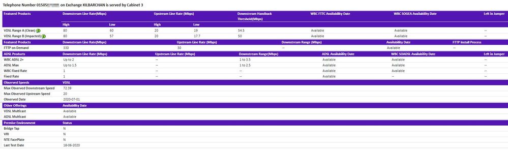

Hi Thanks, for the reply. Info requested attached. Any idea why it would not return to the full previous speed that it was able to attain reliably since the day it was installed up until this happened?

from dslchecker your connection is well within the expected range for your line so BT will do nothing to help
it could simply be more people on your cab since you were connected causing some crosstalk
