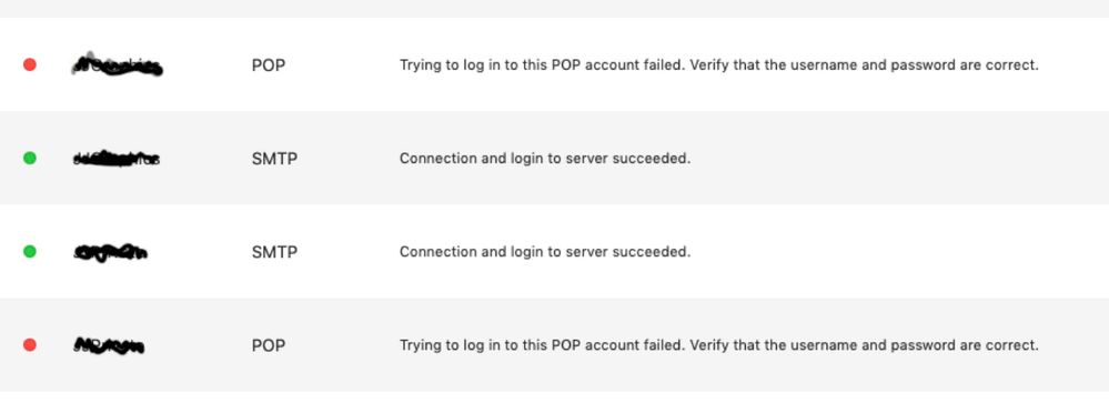

Both my wife and I use Apple Mail (POP, not IMAP) on our iMacs running the latest version of macOS and until about a week ago both have functioned faultlessly.
Both machines now intermittently show the "mailbox offline" symbol for some of the e-mail accounts and intermittenltly ask for the passwords for some of the accounts. Sometimes everything works normally.
No changes of any kind have been made to the settings in Mail on either machine. I have verified that all the Mail settings and passwords are correct.
Using the basic diagnostics, it appears that the POP passwords are being randomly rejected by the BTMail servers whilst the SMTP connection is fine:
When a message is sent to one of the accounts which appear to be offline, it jumps online and receives the message.
Is anyone else experiencing this problem or have any ideas about what is going on?

I am going to hazard a guess that you are on the BTYahoo email system and not the BTMail system, is that correct?
If you are, there have been problems with the BT IMAP/POP servers stopping email clients from accessing the users email account for years. The advice from forum users is to do nothing such as changing passwords or deleting and resetting up accounts as this invariably causes more problems than it solves.
If you were still able to access your email via webmail it is obviously not a problem with your email accounts or with your password, hence the advice not to do anything. The problem usually resolves its self in within a few days.

No, I'm on BTMail which has been utterly reliable since I was migrated over quite a while ago. I'm certainly not going to change passwords as I'm well aware of the issues that can cause.
WebMail still works OK . . .

That has surprised me that you are on BTMail because the problem you have out lined is similar to the one that generally only affects the BTYahoo system.
The only thing I would try would be to turn of the Homehub for an hour or so in the hope that when you turn it back on you are given a new IP address and it connects to a different email server, other than that I would still suggest that you do nothing to see if it does resolve itself.

I'll try turning off the hub and see what happens . . .

Turned HomeHub off overnight and it has definitely acquired a different IP address . . . but the intermittent problem with Mail still persists.

The problem I have been experiencing is with the BTMail (not BTYahooMail) POP service using Apple Mail so can't comment about Outlook.
I did not make any changes to Mail or to my Mac (or to my wife's) before the problem started and have made none since, but the problem seems to be gradually going away as I have only experienced one or two drop-offs in the last forty-eight hours. I can only assume that there is/was some sort of transient issue with the BT servers. Time will tell . . .

There were a few changes made last night that should have resolved the issue. If your still experiencing issues with your BT email, please post back and let me know.
