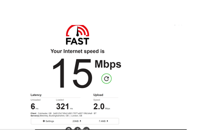

On an old PC connected by ethernet we are getting 1.2Gbps where as a new laptop with WiFi6 we are getting 15Mbps in the evening its right next to the HH2 (During the day we can get 200-300 on the Laptop) - there is no other significant loading on the network either. Called BT and they did say our speed to the modem was slightly lower than expected. A BT engineer is coming tomorrow but is there any possible issues that I should check on the HH2.
Any ideas.

Just to add have been checking with FAST.com as BT suggested and also have to BT Wifi Discs all with excellent connection.

So I have just plugged in a Netgear Nighthawk router to the HH2 and get 210Mbps when connecting to BT HH2 immediately after I get 11Mbps
