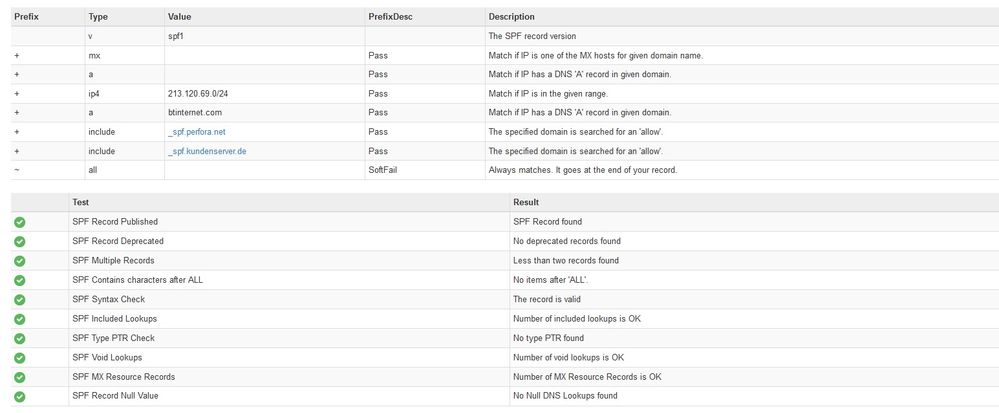

I'm not sure how strictly accurate this is in terms of syntax, but it gives a pass when sending from my domain hosted at IONOS using BT's SMTP server. Its probably the IP range that gives the pass.
v=spf1 mx a ip4:213.120.69.0/24 a:btinternet.com include:_spf.perfora.net include:_spf.kundenserver.de ~all
MX Toolbox seems happy with it
