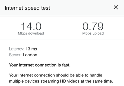

This is my internet speed so the VDSL connection is below 30mbps, it is also connected via copper wire into the cabinet so sounds like the router you have suggested I get would work?

@meg_ wrote:
I have a username in the format firstname.surname@btconnect.com and a password I have set if that is all the details I need?
That could either be a VDSL or an ADSL connection, but I would suspect an ADSL connection, owing to the poor upload speed, which may give you upload issues, which is possibly why you were offered a direct fibre connection.

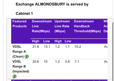

What may help to determine your connection type is this.
Enter your phone number into this form and display the results here, but edit out your phone number before you post the results.
 These are my results, hope this helps?

The test results show you are only on an ADSL connection, not VDSL, which I would not recommend that you use, as the slow upload speed is likely to give you a lot of issues with IP phones, especially if you are trying to send email with attachments. The VDSL upload speed would be better, so I am puzzled why you have been put on ADSL, unless that has changed since the test date of 19th February 2020.
There is no mention about the direct fibre connection, which is odd? If you have that, and its working, then it would be a better option.
