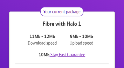

I don't think anyone's actually reading my original post. The issue is that the speed on my actual package has changed, I don't think it's got anything to do with my router.
This is a screengrab from the BT website:
It was 36mb and 30 or so guaranteed.
However, here is the info from that link (although it's not pasting particularly well):

the dslchecker shows estimated range for your connection is 59/44mb but also shows your connection speed on 7/8 was on 13.09mb so there is certainly a problem
