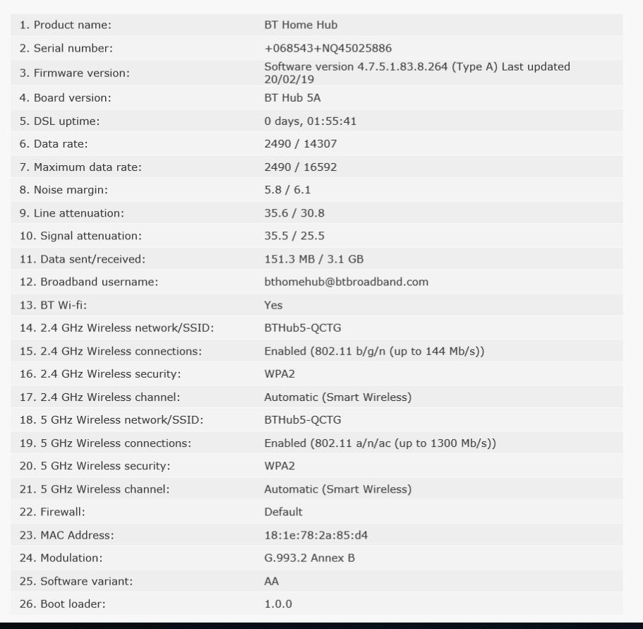

in order for the forum members to help please can you post the stats from your router (if hub enter 192.168.1.254 in your browser) and if  HH5 then go to troubleshooting then helpdesk and if HH6/SH2 then advanced settings then technical log information .

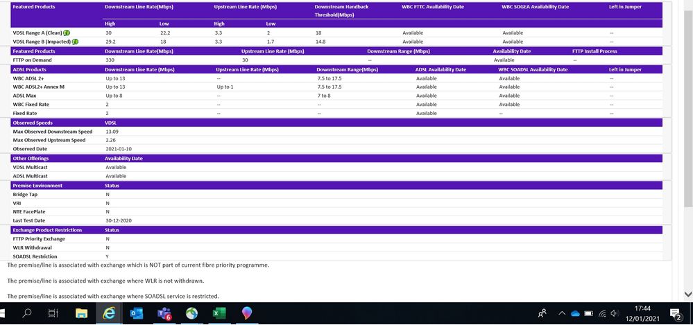

Message 3 of 14
Re: Open Reach wont fix our wiring problem

you cannot make openreach fix your line just because you cannot get  the minimum speed shown on the dslchecker  if you have noise on your phone line then you get opereach back to get your phoneline fixed not broadband
