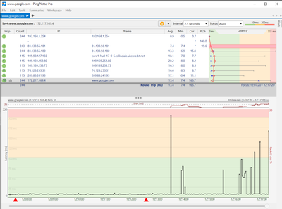

I have the same issue - here you can see before and after netflix starting. first spikes are through browser, second set through chromecast on the telly. There seems to be a lot of jitter. Suring this test my youngster is playing Fortnite battle royale online.
The effect on more competetive games like Valorant, Call or Duty is catastrophic. There is simply no point tryign to play. Switch off Netflix and they are smooth as butter
