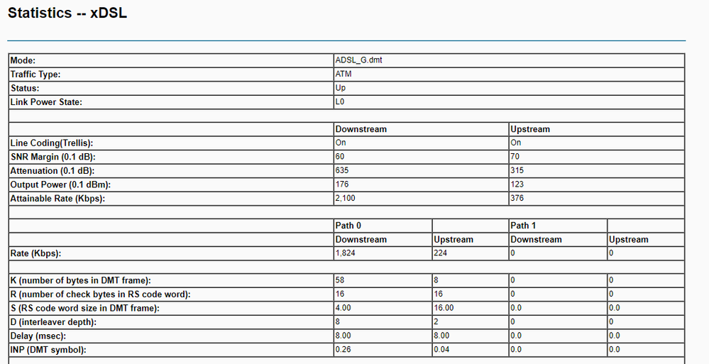

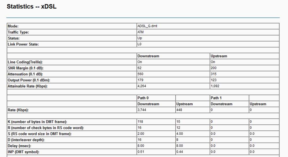

Hello, I have two ADSL connections which I have been using for some years now.
A few weeks ago, I noticed that one of the connection was being very slow and it is like that to this day.  At first, I thought it was due to busy network due to Coronavirus.  However, it was gradually getting a bit worse so today, I decided to have a look at modem statistics, it turned out that 2nd line has very poor connection, is half the speed of what it should be. Also upload speed is poor.
Have a look below and you can see the difference.  Both ADSL sockets are sitting next to each other and nothing has been changed.
ADSL Connection 2ADSL Connection 2
ADSL Connection 1ADSL Connection 1

Also both modems are connected to master sockets and no telephones or anything connected at all, just ADSL lines. What else it could be?
By the way, you can see noise margin is 'normal' at 6.0 dB on ADSL 2. If it was noisy, SNR margin would it be high?
But line attenuation seems off, it should be same as ADSL 1.

your attenuation on 'good' line is 56db but on 'poor' line it is 63.5db and may be higher as that is maximum router will show.  Hence why you need some way or other to get both your lines checked for line noise but I think poor line does have a line problem
