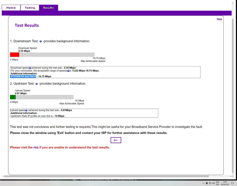

Over this past week I have suffered from poor inconsistent broadband connection dropping out regularly with very slow speed constantly. Working from home has been made impossible.
It looks like my connection has been downgraded from fibre to adsl . Should have 45-50 down / 8-10 up but am only achieving 1.5-2.5 down / 0.3-0.9 up.
There is no service fault in my area, and the BT Broadband fault diagnostic will not complete on any of my devices (stalls at 99% every time). Understandably the BT is looking after its staff, but i've spent over 2 hours waiting to connect with customer service this week with no success.
Can someone please direct me to where I can get this sorted, as I have had no luck with customer service?

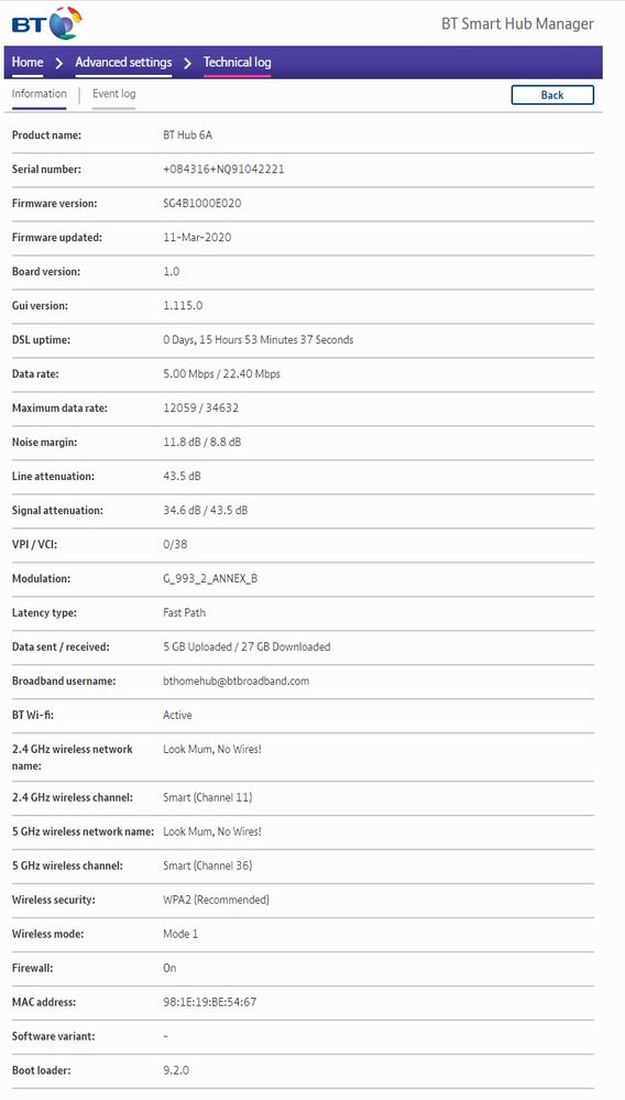

according to stats you have a 22mb connection speed which is well below expected.  your connection time is only 15hrs is that due to hub dropping connection or manual reset?

was btspeedtester done using an ethernet or wireless conenction?

Thanks for getting back to me.
15 hours is when the hub last dropped out.

All testing has been conducted using ethernet connection.
