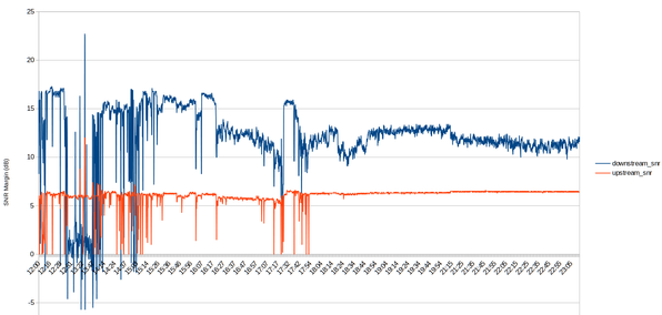

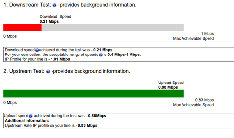

For the past few weeks, I have been having continuous drop outs on both Broadband during spells of windy weather. The broadband will drop out every 2-5 minutes, and the SNRM jumps around continually. The constant drop outs have resulted in my SNRM rising from a normal 6dB to nearly 20dB and broadband speed dropping to an almost unusable than 0.2Mb from the usual 5-6Mb.

BTW Line Test:
Graph of SNRM during 15/02/2020:
