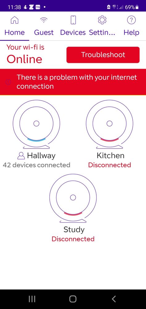

@foz. BT also contacted me for more details on our recent experience - I have offered them my diagnostic logs, but they have not come back to me yet. My setup unfortunately had a complete meltdown again on Wednesday this week - 2x satellite disc’s showing red, a reset and a power cycle wouldn’t fix it and the primary disc rebooting every 15 mins or so. I eventually  got the 2x discs back buy connecting them by Ethernet cable directly to my router so they could sync (tip BT Support gave me in the past) so avoided a factory reset.  The DHCP server setting on my ASUS AT-AC87U still at max lease time (no infinite option). I’ve got to say that since selecting max lease time things are slightly improved, but its marginal at best for me. That said, I’m sticking like glue to 822C to avoid further complications at the moment until I’ve got confidence everyone else is working well, but your status is a good start!
