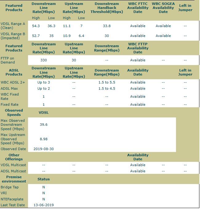

your router stats show a 39mb connection speed which is virtually at attainable and at bottom end of your expected connection range according to dslchecker results   your noise margin at about 6db is normal
which exchange and cab are you on?

from the dslchecker results your line speed estimate is 54/36mb.  You can only get as fast as your line can handle and you are yo far from the cab to get the superfast 2 speed of 80/20 and your estimate is not even as high as superfast 1 speed 55/10mb
can number is shown at top of dslchecker results but you have deleted before posting

From dsl checker
Exchange HAXBY is served by Cabinet 27
