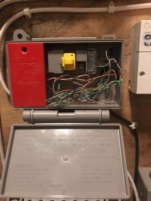

Apologies for the incorrect picture. I managed to locate the box you described in a locked cupboard just outside of my front door! Pics below. Thanks

That’s an External NTE. Openreach started using them years ago. They were supposed to make life easier regarding access to people’s properties.
Then FTTC came along and they soon realised they caused no end of issues with VDSL so they stopped using them.
Whats now supposed to happen if an Engineer comes across one is remove the NTE Component, crimp the External and Internal Lead In’s together and convert the first LJU it goes to into the NTE and or just run a new lead in to wherever they want to fit a new Internal type NTE5.
