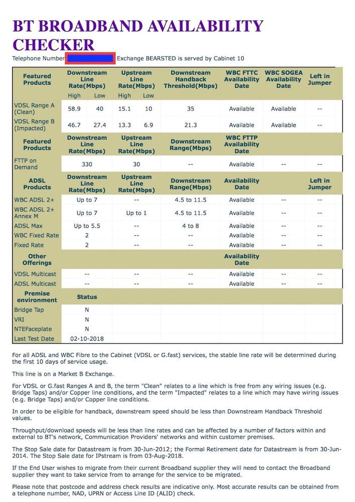

according to the dslchecker you would expect a minimum down connection speed (not download speed) of 35mb
as you are using a modem and HH3 all the meaninful stats are held by the modem which needs to be unlocked before you get access
run btspeedtester and when first test completes then run diagnostic test and post results   http://www.speedtest.btwholesale.com/
