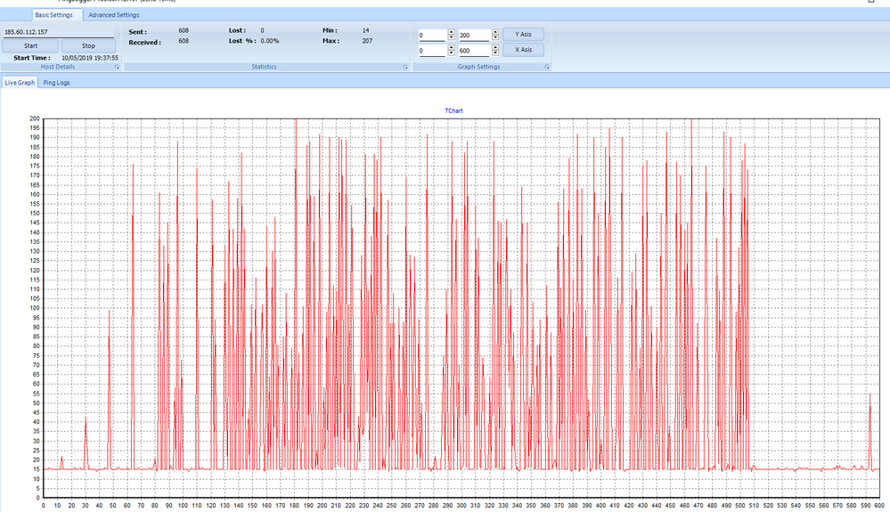

I found a slightly better ping graphing application in terms of having some clear axis, it's from pinglogger .co .uk.
Pinging the same Overwatch game server and pinging every 0.5 seconds, so 5 minutes worth of pings.
Virgin work connection, spamming the hell out of Tidal skipping tracks, 30+PC's as well.
BT connection "Perfect for streaming, gaming, watching and downloading in HD on multiple devices", playing 2 Tidal track and netflix on another PC - what a JOKE !!!!

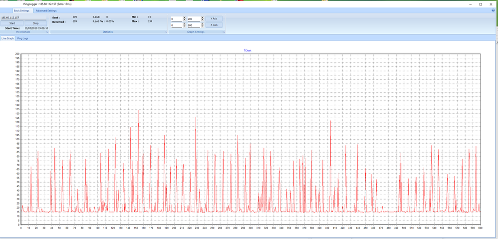

The engineer is coming Monday, yeah great idea to email traffic data if he / she is willing - I hope a fault is found because if BT is this bad sooner or later they'll going to lose customers.
Here's another trace, this time using a high performance PCIe NIC, I was using a USB NIC because it seemed to help my gaming performance, I was spamming the next track on Tidal here, the last ~100 pings I stopped to show that if my network is quiet then I get a good ping.
