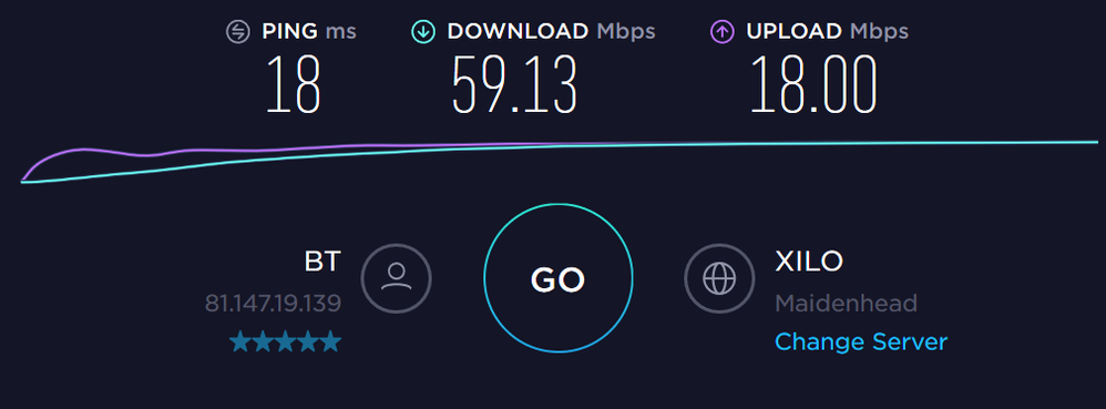

BT said that they would be making some changes to my setup overnight so I thought I would run a quick test this morning.  Unfortunately the spikes are still there but not into the red as they previously were although that could just be a time of morning thing.
Two noticeable differences were (1) the number of hops to the destination address was reduced and there was packet loss at a hop where there hadn't been before and (2) the speedtest result was better in that it pretty much shot straight up to maximum bandwidth rather than the usual low for a second or two then increasing.
This image is from 20 August:
This is from this morning:
Speed test from 20 August - you can see the gradual incline of speed:
Speedtest this morning was a lot quicker to settle at top speed:
I'll keep monitoring over the weekend and report any significant changes.

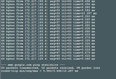

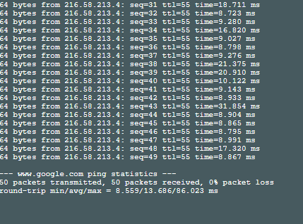

Personally I'd use the same speedtest server when running the test,by those screenshots your ping almost doubled.
And I gather that test was with netflix running?
For me every time I've a video running  on Youtube or Netflix etc I get huge ping spikes always the same no matter what since December.
The screenshots I'll post are from this morning with one Youtube video running and only me using the internet so you can imagine how bad it gets when the whole family are using the internet streaming or even just watching Youtube.
I get ping spikes of over 250 when I'm gaming with someone watching Youtube!
Ping without videoPing without videoping with videoping with video

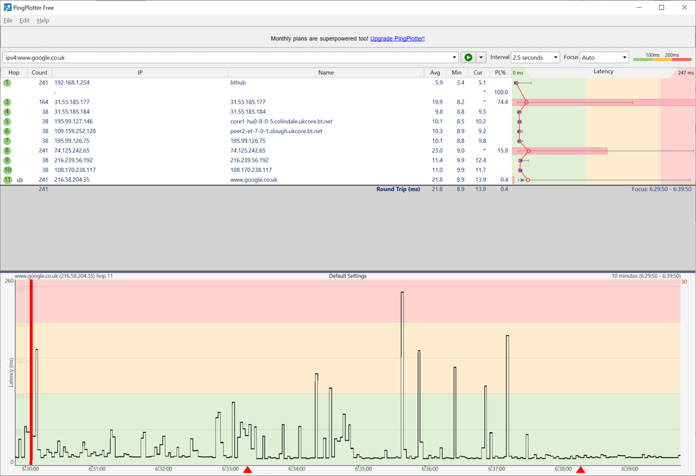

Re: Recent online gaming ping spikes when streaming Netflix
Here's my pingplotter to google uk btw, whilst connection is idle.
1dc28ts
