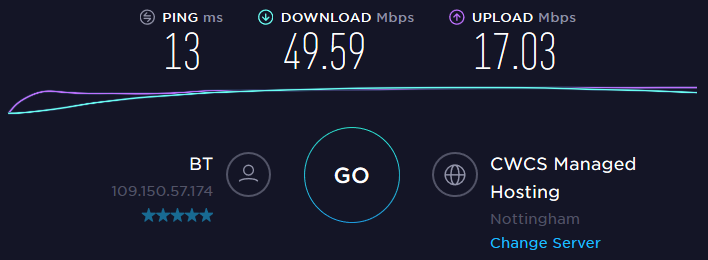

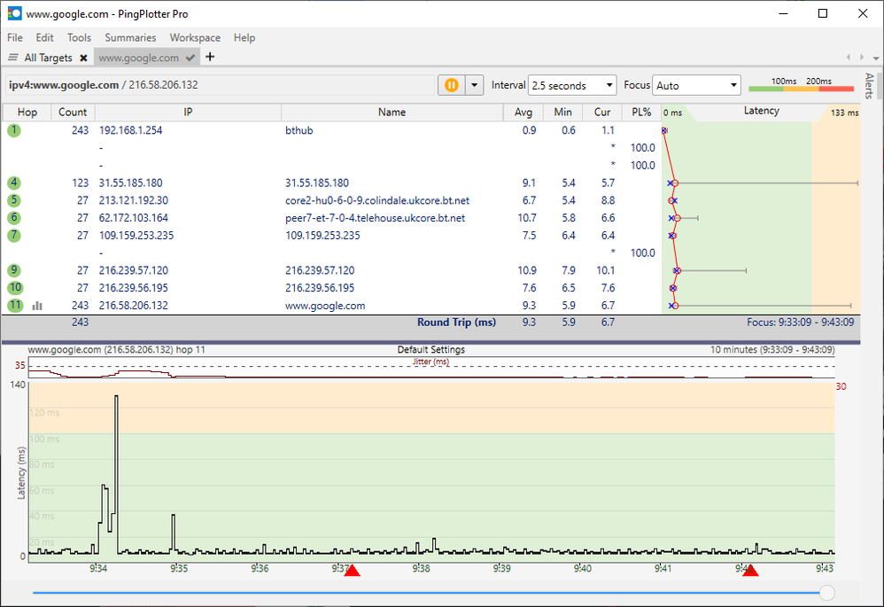

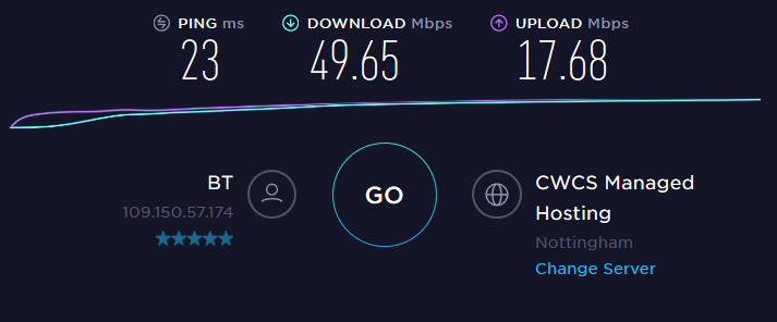

Just updating the forum and mods following changes made to my profile during the early hours of Friday.  Sadly, there has been no difference to performance and the below graphics clearly show the difference when idle and streaming.
The below are before, during and after streaming Netflix in 4k. The pingplotter results speak for themselves. It's like night and day.
Before streaming:
During streaming:
After streaming:
