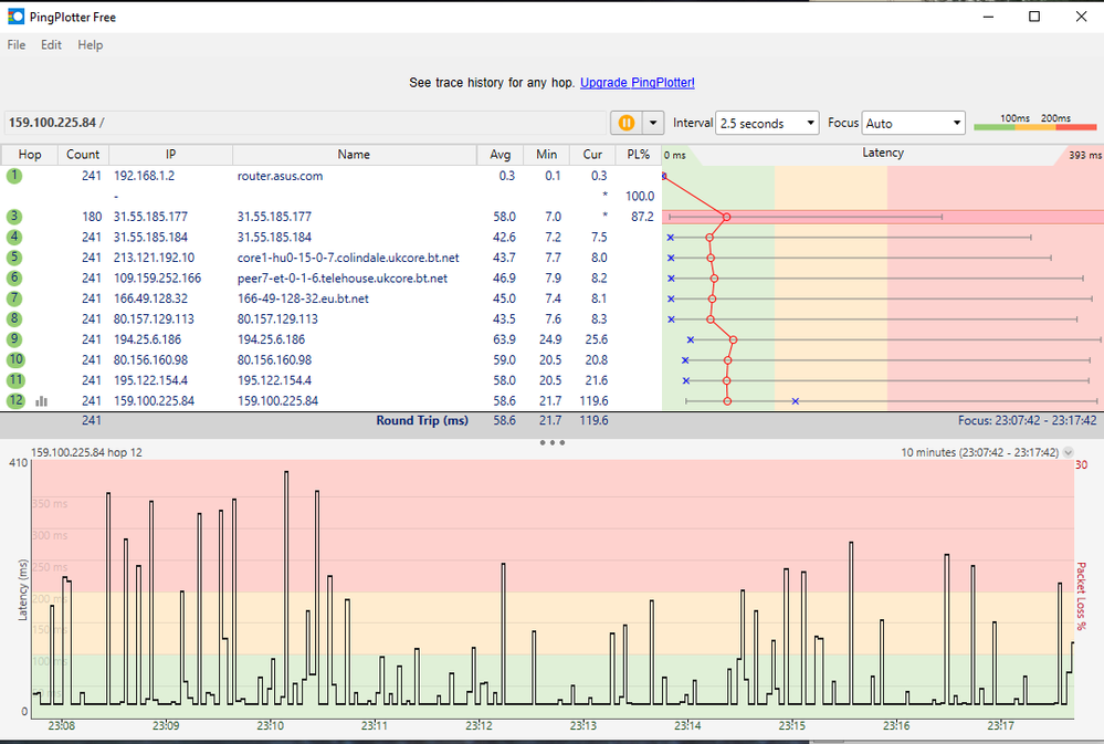

Below is a before and after ping graph to a gaming server without QoS enabled: (QoS gives me even better pings)
Before BT Fix :Before.PNG
After BT Fix:
Don't give up hope,  I was  looking at alternatives until I received a PM from the mods, I did not think they would fix the issue but they have.
