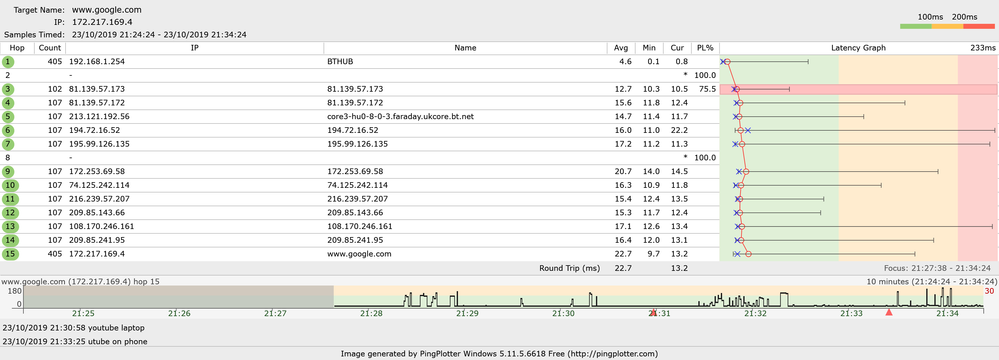

This is mine after the fix... Unfortunately no difference whatsoever.
Not hard to notice the exact point I switched streaming off.

@Eyebaws
I can't see the max y scale value of the ping graph, is it 20 or 200 ? if it was 20 then I'd say you've got a good ping.
