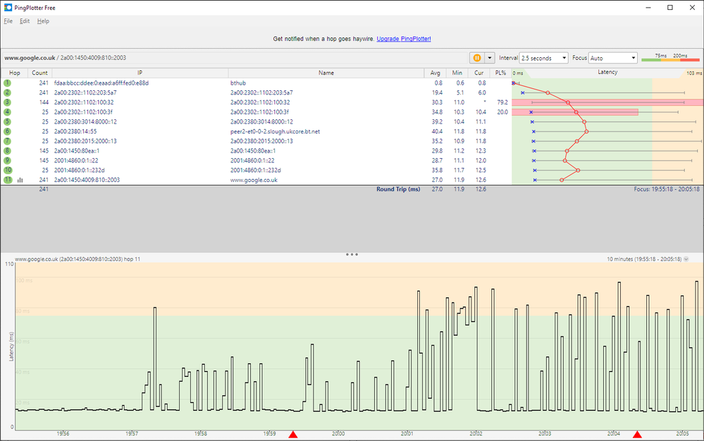

I've currently had 2 fixes implemented on my line, the first did nothing, but the second has actually improved things. Previously, any type of streaming would cause major latency spikes (300ms), but now, the severity has dropped to 100ms spikes and only for Netflix.
The graph below from PingPlotter shows how my latency changes when going from no stream -> 4K Youtube -> regular Netflix. It blows my mind how Netflix at a much lower bitrate causes higher latency fluctuations than streaming a 4K video on Youtube.
Whilst games are playable at 40ms, the constant 100ms spikes from Netflix render most online games near impossible to play without freezes/constant stuttering. Is there any way this can be looked at and addressed like the other streaming services which have been seemingly fixed? @RobbieMac
Again, as others have mentioned in this thread, there is certainly some form of traffic shaping/prioritisation at play here to ensure VOD users have a good experience. Whilst that's understandable, ISPs have a duty to be transparent about any shaping/prioritisation at the point of purchase which is clearly not the case with BT. If this can't be fully resolved, I'll be escalating this by emailing the CEO and writing complaints outlining the issue so I can move ISP without charges. Hopefully BT get a handle on this in the future and make it so other users don't suffer as a result of streaming services - there's enough bandwidth to go around!

Hi @JamesCO
Thanks for posting back and apologies for the delay getting back to you.
I am still waiting to hear from my colleague about your case.  I have contacted them again asking for an urgent update and I will give you a shout as soon as I hear word back.
Cheers,
Robbie
