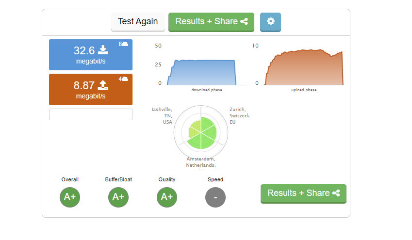

As below here's my buffer bloat scores, my bandwidth is 65 ish Mbps down and 17Mbps up, as mentioned I just carve that up so everyone on my network can do whatever they like, download, stream etc,  it'll have no effect on my gaming at all. I allocate myself 32 Mbps down and 9Mbps up which is plenty for gaming, I could go higher but I prefer a paranoid safe margin.

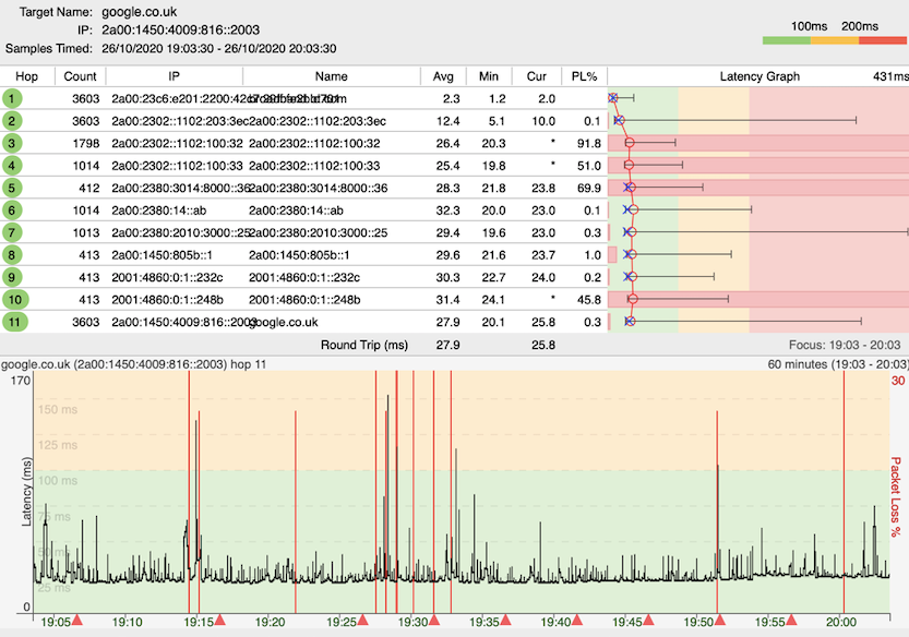

Im getting ping spikes when gaming alone - even when streaming is taken out the equation. This picture below is from one game of Modern Warfare multiplayer last night to test. No one else is using the line, only me, you can see how flat it is before and after the game. You can see the ping shoots up to 180ms+, when the game ended I went to dashboard and let it sit idle before shutting down.

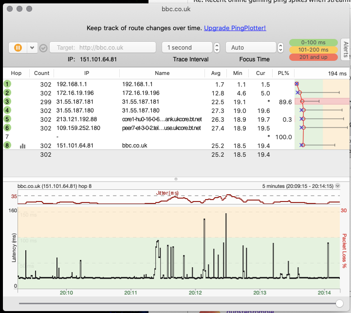

This graph right now is from my partner watching an Instagram video on her phone.
And this is from me starting up Netflix after the one above and starting a 1080p stream:
For comparison this is from last week from before I switched out my BT SH for a 3rd party router. This was a 1080p Netflix stream playing on TV while my partner was online shopping on her mobile.

Wow BT SH sucks, changing to a 3rd party router has definitely cleaned up your connection.
For a wired connection 180ms shouldn't be happening, the rest of the pings are definitely bad enough to ruin any kind of online gaming.
The pings to your gateway (192.168.1.1) look a little high, these typically should be less than 1 ms, I'm just guessing but this suggests Wifi to me, testing using Wifi and / or gaming using Wifi isn't going to give you the best / reliable results.
Modern Warfare from googling uses about 1.3Mbps, which seems about what I'd expect, so gaming alone shouldn't cause any issues.
What you're showing has characteristics of the BT infrastructure problem but I'm struggling saying that's definitely the cause, when I was with BT my ping was very stable until I started putting load on it, gaming on a quiet network was absolutely fine, when I say quiet I mean silent, if anyone breathed on the connection I'd have ping problems.
If it was me I'd make sure the network is stable with nothing on the network, for example just leaving a phone switched on connected over Wifi can be doing all sorts of background network usage, same for a PC / laptop, Windows updates, connections for anti-virus, Microsoft telemetry, Nvidia telemetry and so on.  I'd watch the ping for a while, you need to see no excessive spikes, if there is you need to figure out where these are coming from,  it'll likely be from your test PC / laptop - some back ground network usage or it'll likely be from the quality of your VDSL connection to the road side cabinet. This is where you need to dive into your router / modem and look at your DSL statistics.
I'd be interested to see a ping plotter to bbc.co.uk while you do a 'speed test.net', I'm just wondering what your max ping gets to and whether you see any packet loss.

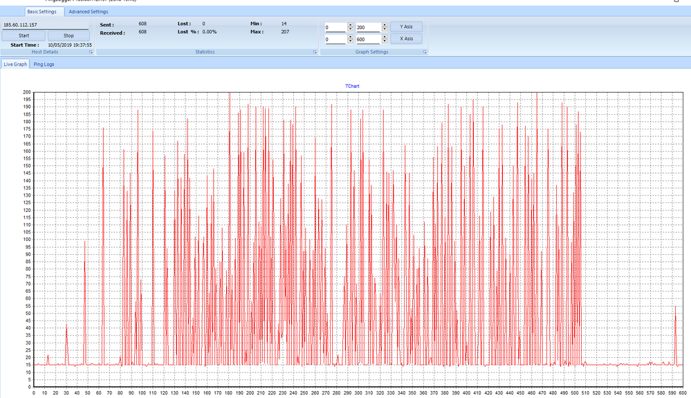

This is what I had with BT, here I was skipping next track on Tidal - hires music streaming, shortly after they applied a bodge fix without telling me. If I was ever tempted to move back to BT I just need to look at this picture 🙂

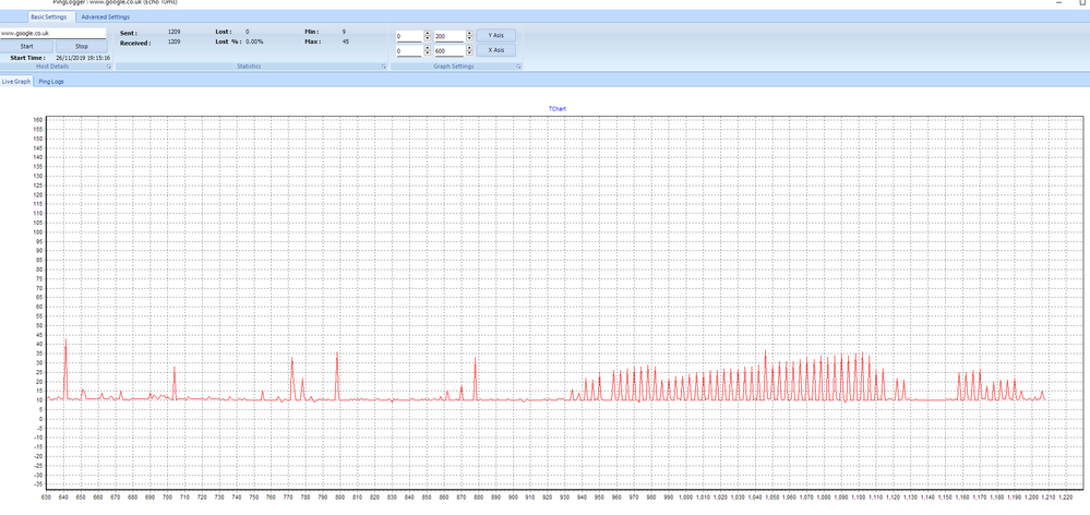

Just to add to this, below is twitch streaming via BT when they applied their interim fix, this is typically what you'll get on any reasonable internet connection, ping spikes of 40ms ish, just the nature of how streaming works.

Correct those ping plotters were done over Wi-Fi as I needed to work in various rooms of the house yesterday (console is hard wired though, along with the smart TV which displays Netflix).
