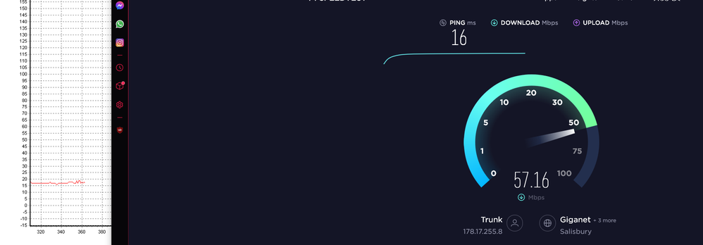

Message 1000 of 1,014
Re: Recent online gaming ping spikes when streaming Netflix
With correct gear and setup you should be able to run ping spike free, as below see a snapshot of an active speed test .net, obviously this is the worst case scenario consuming the max bandwidth I've allocated. On the left is a active ping graph pinging every 1 second and as you can see there's only a few extra ms of latency. I'm with leetline so if I can do it then everyone else should be able to. I can't comment on whether BT still has issues but if you've got a clean FTTC connection there's no reason why the below can't be achieved.
