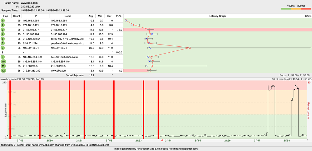

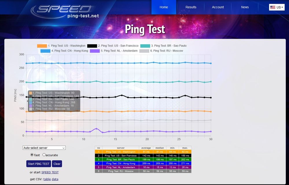

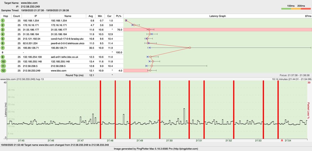

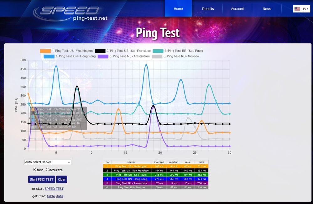

Still having the same issues 6 months later... As you can see from the images below, the problem has not been fixed.
Does anyone know if the new full fibre offerings from BT have the same problem? I am on FTTC Fibre at the moment but still locked into the contract until Jan.
Ping - no streamingPing - no streamingPing with streamingPing with streaming
