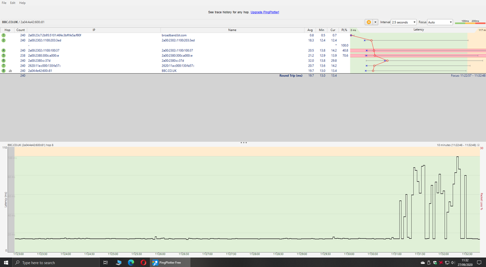

@dubstepzombie Just trying to prove a point. There is the graph with no one using the connection then at the end I fired up Our Planet on Netflix HD. Graph you saw yesterday was my wife streaming IPTV on her laptop, that always killed the connection even more than Netflix.2020-09-27.png
