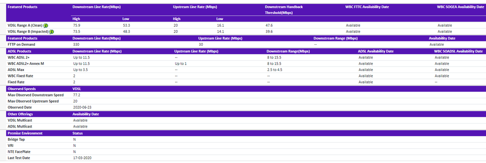

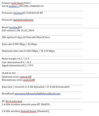

in order for the forum members to help please can you post the stats from your router if HH6/SH2 then advanced settings then technical log information .
enter your phone number and post results  remember to delete number   https://www.broadbandchecker.btwholesale.com/#/ADSL

Thanks. Here are the stats - hope they are the ones that you suggested

can you check MYBT as it looks like you are on Fibre 1 and not fibre 2 hence why speed is 55/10mb

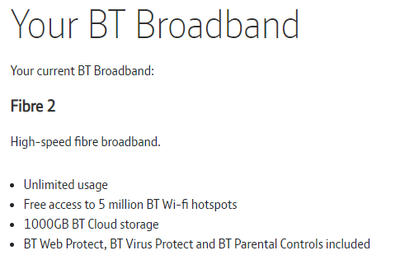

Thanks again for your speedy reply. This is what it says on my BT:
So should I register a fault with BT? Also, could you please explain what is it that makes you think I am on Fibre1 rather than Fibre2?

your stats show connection speed of 55/10mb which is limit for fibre 1 whereas your speed would be higher nearer 70/18 if fibre 2
