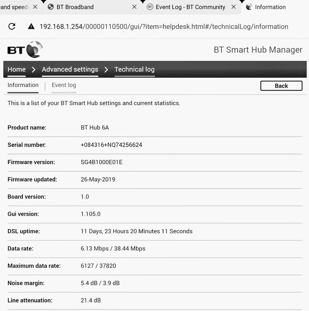

Screenshot_20200315-155633_Chrome.jpgScreenshot_20200315-155633_Chrome.jpgScreenshot_20200315-155205_Chrome.jpg

Thanks for your quick reply, see my details above

Your connection stats look good. Presuming there is no noise on your line I would suggest you are a victim of crosstalk. There is nothing you can do about it.

I agree with @pippincp stats look as good as you will get and with noise margin down at about 3db suggest you have had a boost from G.INP
