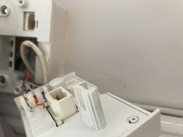

I've read that to terminate the extensions, you can pull the wires out and tape them up but that you also need to disconnect the extension from the master socket as well, which you can access by unscrewing the bottom plate. Here is a picture of the opened master socket:
So is this is a case of just removing those three wires in the foreground? And if so, is it OK just to tape them up and keep them in the socket?

by removing the wires on the back of master that should disable all extension sockets
connecting a specific extension socket may not be that easy as reconnecting the wires at master would make all extension working again and you would then need to disable the extensions you did not want/need connected.  Your extension socket may be connected to another extension which in turn connects to master so would need to be left working as well

Thanks, that makes sense as I've read elsewhere that extensions are on a daisy chain so they may all need to be re-connected.
