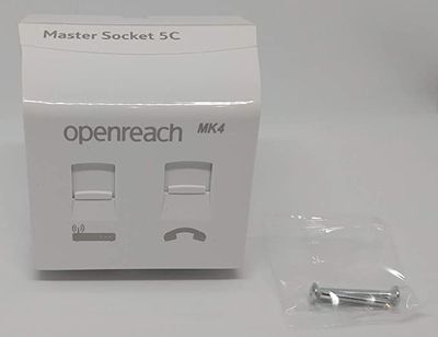

Hi @Matt13 which type iof dual socket. Is it master socket 5c? If yes there's a test socket inside

Just went and checked and yes i do have a 5c master socket, however when i brought this up to BT they gave me the impression this socket does not have a test socket. I did take the front cover off and i could see that a filter would fit into the slot where the front panel goes.

That's the test socket.

Good, i can just plug my router and phone into that with a micro filter and if the issue stops because of that do i just need to get a replacement front cover or socket?

If everything works with a microfilter in the test socket then it would point to a facetplate issue. It may be something as simple as the faceplate not being seated correctly in the beginning.

@Matt13 If your hub works fine in test socket then there are two possible faults -
1. The front socket plate is faulty or
2.any extension socket  in hour house is faulty and causing  interference.
Note when you connect your hub in the test socket  (with a filter) the line is totally disconnected from any internal wiring. Test socket is the point which is directly connected to outside wire. So you can be sure that any internal wiring /socket within your house is causing interference or not.
