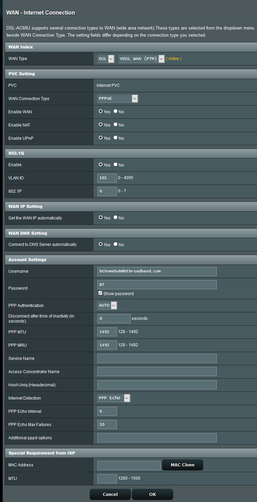

That's what we thought but since Thursday the ADSL connection no longer seems to work which has left us very confused.
These are my settings. Is there anything obviously wrong?
3,633 Views
Message 4 of 10
Re: Setup BT Fibre With Asus DSL- AC68U
All looks ok, have you considered the ASUS may have gone faulty hence the loss of broadband in the first place.
