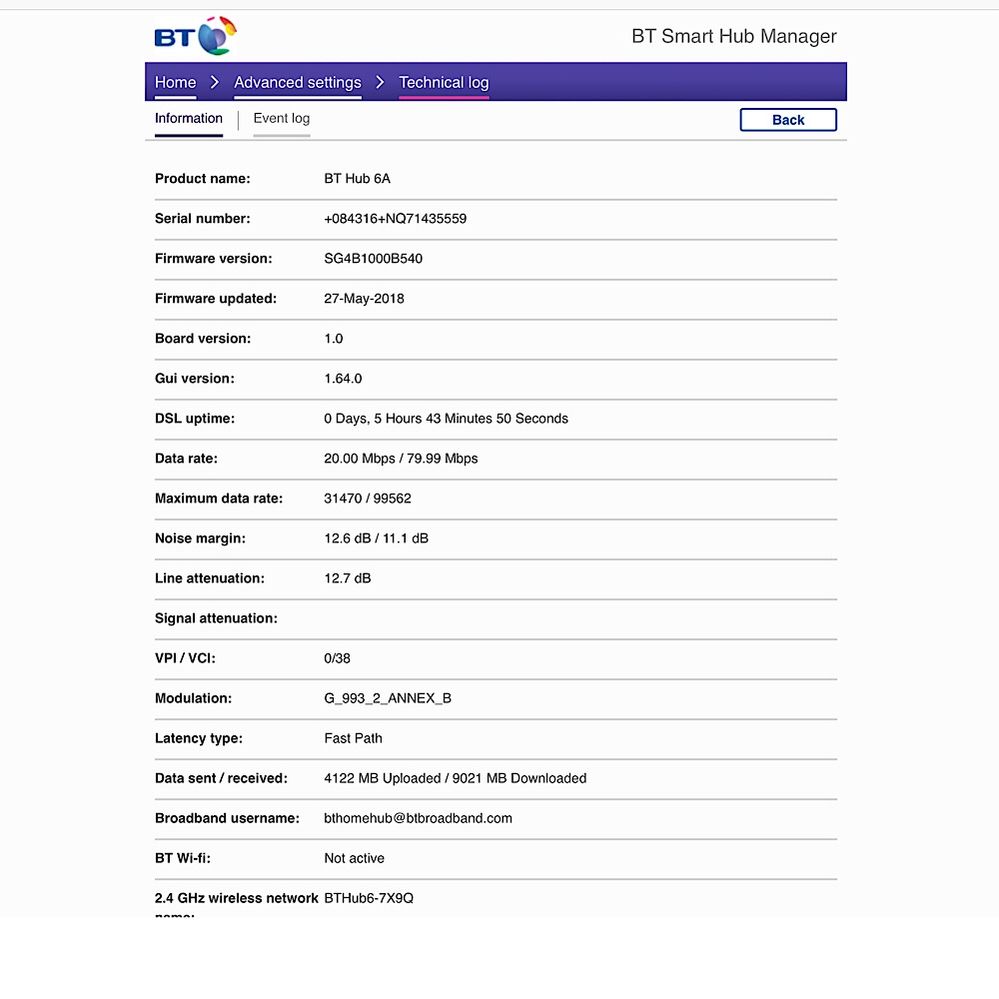

I’m not sure what’s happened but I check my router log daily at 10:17am everyday it does it TR69 always the same 2 periodic and 4 value change. Never had a drop out no noise on the line alway 20/80 sync.

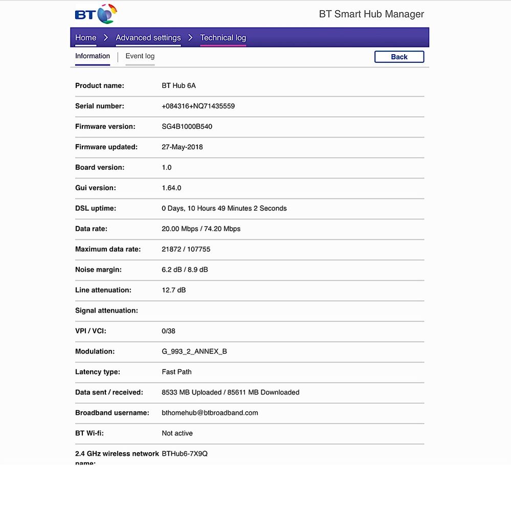

‘Anyway today I noticed I have 10 hours of uptime checked my log this morning at around 8am it did TR69 4 value change then 4 Value change right after. 10:17 it did the usual 2 and 4 report.
Then I noticed my sync had gone from 79.99 to 74.20 and my noise margins have dropped a lot my upload is now still at 20mbps but is on the minimum of 6.2 from its usual 12. And the download has noise margin has dropped to 8.9 from the usual 11.

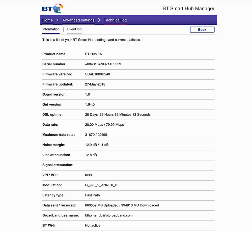

A screenshot from August 10th
‘And from today
What has made my noise margin collapse like this?

Turned the hub off and left it for 35 minuets, things look pretty much the same. Noise margin is still 50% lower than it normally is. Anyway here’s a screenshot following the restart. 👍
