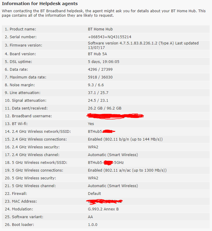

So, I have absolutely no quibbles with BT at all, besides this niggly slow upload speed. Now, I can't complain too much as my download speed is phenomenal. However, my upload speed is pretty dire - considering it's 2018 and video/streaming is a thing.
I've done all of the numpty Live Chat troubleshooting in the past week i.e. resetting the router for a bit but this has been of little use.
We have FTTC/Infinity and a filtered master socket FYI. I'd really like to know why the upload speed is so slow; why is the noise margin that high and why am I so far off the achievable upload speed proposed?

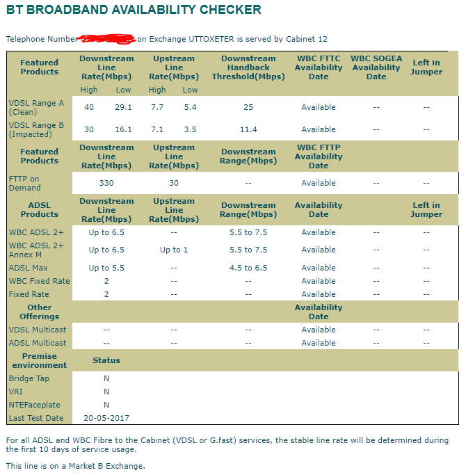

enter your phone number and post results  remember delete number  http://dslchecker.bt.com/adsl/adslchecker.welcome

Thanks, imjolly.
Here it is!

I've managed to give this a go this afternoon. The results are exactly the same, see below.
Definitely looks like a problem beyond the house, unfortunately.
Any other ideas?
