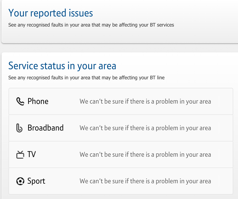

any problems shown for your area?  https://my.bt.com/consumerFaultTracking/public/faults/tracking.do?pageId=31
1,992 Views
Message 7 of 9
Re: Slow upstream sync from 9am today
Go to solution
Doesn't seem to be...
