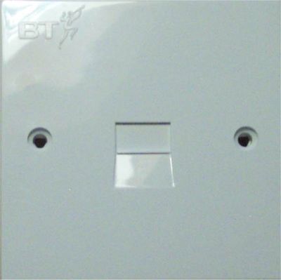

what type of phone socket do you have?  like any of these

Thank you Distinguished Sage for keeping going with this... the socket is the big one in the middle of your picture, the most primitive kind.
However, to complicate matters it turns out this is not a "master socket". Excellent Openreach engineer (and I don't often praise them!) found the master thingummy under a plate, not a socket as such, in an attic room, from whence he tested line with exchange etc.. He did not think, to be honest, that getting everything rewired by a BT engineer would make a major difference, and (after all) we were getting better speeds with our old EOL/ADSL line ( usually 5.5, but up to 7.7 at best).
I would be loath to spend more £hundreds on rewiring when the problem is most likely elsewhere.

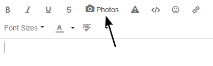

When you reply click on the arrowed photos button, browse you the image on your device and click select file. Then click Done.
