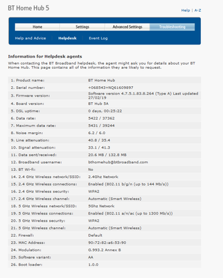

So i was on a fibre line, that was always reporting 78down and 19.9 up, and now its reporting 37 down, and 5 up, which is just shocking, can barely download anything with how slow this speed is, ping is now 20-30 instead of the old 10 ping, the router never ever restarts unless i restart it manually, and it never drops connection either, so im not sure if the router was confused from me moving it, or i've been randomly downgraded to some low-end connection, I did not expect to be paying £80+ a month for a 37mb down and 5up connection... I've restarted the router 400 times, even switched cables and still same crappy connection results..

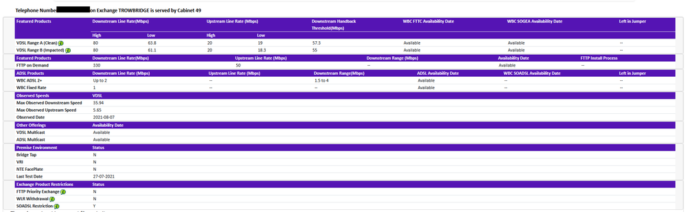

DslChecker =

Restarting your router "400 times" will do nothing except eventually make your problem worse. DLM (Dynamic Line Management) will see this as a fault and lower your speeds to try and maintain a connection.
Report a fault as has previously been suggested and stop restarting your router.
