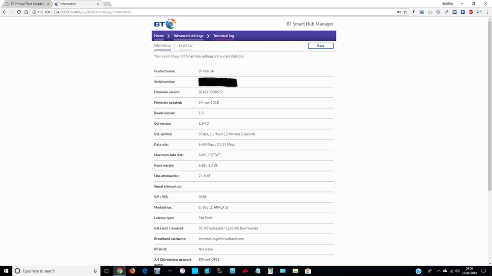

Have been having problems off and on since christmas when after posting on here I was contacted by @NealO, I was getting constant drops (5-6 times a day)  BT sent me a HH6 which has been an improvement but am still having problems.
Yesterday evening the speed dropped from a solid 45Mbps to 30Mbps. For the last few months when looking at the HH6 stats the 'Maximimum Attainable Speed ' has  from time to time been less than than the atual speed - I have reported this multiple times to BT and got nowhere fast. I have also reported the current problem but again don't hold out much hope of  a satisfacory solution without moderator help.

can you post up router stats on router advanced settings page.http://192.168.1.254/0000016400/gui/#/main/

The speed is roughly 30 down now (from 40-45 yesterday and for the lasst three months) have had several disconnects in last month and when check stats the maximum attainable speed is way lower than actual (Usually comes back up within minutes or few hours but hasn't this time)HH6 Stats.png

what exchange you on and what speeds does dsl checker give?

from your stats your conenction speed is almost same as your attainable speed at 37mb which according to the dslchecker is right at bottom end of your estimated speed  your noise margin is down at 3.3db suggesting that G.INP is active
